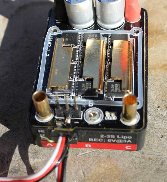

Continuing with our theme of breaking things, last Saturday Ryan's car ground to a halt because the middle of the three motor connectors pulled out of the body of the esc.
Is it possible to dismantle these things and resolder?

That looks like a manufacturing fault - is there no chance of returning to the supplier for a replacement?
Other than that a repair would probably be possible if you can get inside. Is the case screwed together, clipped together, or sonic welded / glued? My guess looking at the picture is it might be glued, if so it's going to take some careful cutting with a sharp Stanley knife to split the case open again along the join line.
If it can't be returned for replacement I'd investigate how the case has been sealed. Screw fitting should be easy enough to see - though they may sometimes be hidden beneath stickers. If it's clip fit then a knife blade inserted into the join line of the case should go in relatively easily, the thickness of the blade itself is often all it needs to spring the tiny plastic clips holding it together. As I said previously, if its been glued / sonic welded you are going to have to carefully cut your way in.
What make / model is that ESC? Maybe a search of the internet may come up with other people who have had a similar problem - and hopefully a solution.

Hello Richard, thanks for your comments.
The esc is a hobbywing ezrun sc10. Sean and I decided to try and take it to bits to have a look. Its a bit out of focus, but you can just about see the small brass coloured circle in the middle of the solder land. It seems as though the brass connector tubes are probably mechanically secured or riveted through the pcb before final soldering. The tube that pulled out has got a small hole ripped out in the bottom to match that visible in the picture.
We didn't try any further disassembly, the lower plastic case seemed to be glued/potted or molded into place.
We did try and resolder the tube , but struggled to get enough heat into the joint. It worked for a while then came loose again.
So I guess its the junk box for that already!

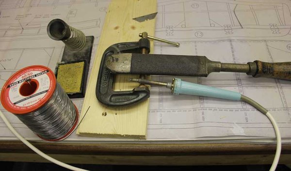

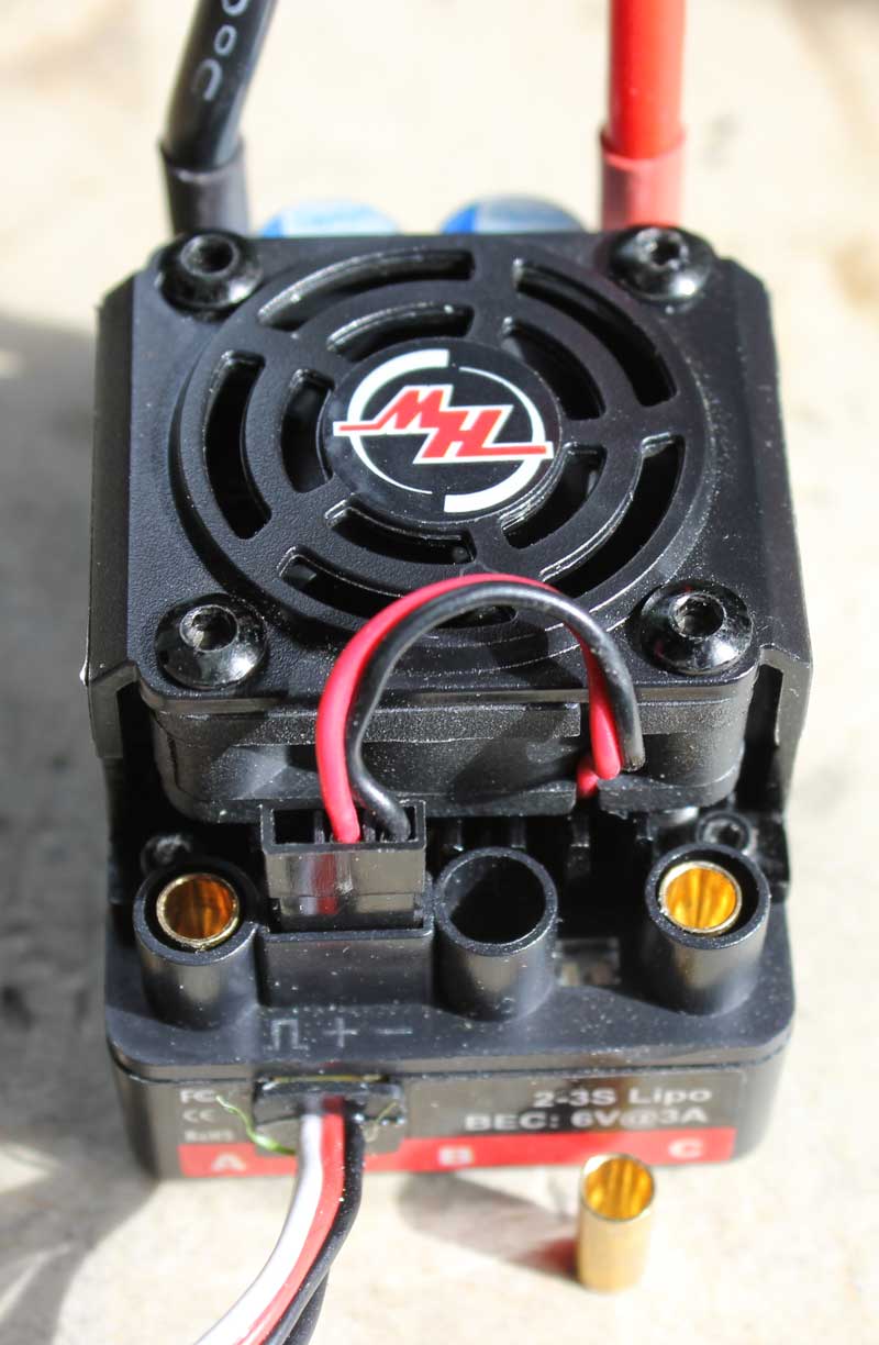

Hello Richard, thanks again for suggestions.
We had another go resoldering the tube, my usual iron on the left is about 45W with a 'number 7' temperature bit fitted, the one on the right is about 125W. By using them both together we finally managed what looked like a fairly convincing joint. Next problem was squeezing it all in the mad rat. We used the big iron to unsolder the red and black battery leads and refit them horizontally on the esc battery terminals. Then we found that the inline plugs on the motor leads didn't allow the cables to bend sufficiently to fit under the body shell. So we tried unsoldering the plugs from the leads and resoldered them with the wires at right-angles. Although this gave the required body shell clearance, we ruined one of the plugs by allowing excess solder to run down into the springy part of the plug which had the effect of making it intermittent, so we ended up soldering the motor wires directly to the esc tubes as shown below. Then we roughly cut a hole in the body shell to give a bit of room for the fan. We tried running it without the fan and it got very hot very quickly! Regards
Re: ESC broken?
I guess we've got it to the stage where its useable. I believe Sean finished second in his final and the car is still in one piece.
