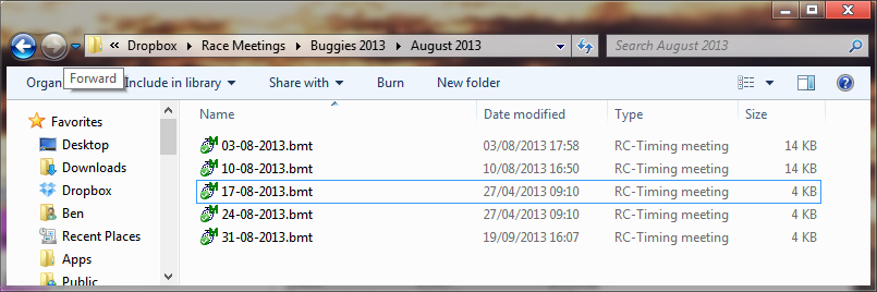

Well I've been playing with rc-timing and the data I copied from the laptop. As far as printing out the results for my own use, it all works fine up to and including the meeting of 17/8/2013, but if I load the 'c:/race meetings/ buggies 2013/ dboots GP 2013.bmt' meeting, or 'dboots GP 2013 2.bmt' meeting, I just get error messages when I try and print.
For example, if I try and print 'Final Result', Race 1, Round 1, it gives me '1 is not a valid race number'. If I input any other value for Race: or Round: I get the similar error. If I select 'All races' then the error message says 'There are only 0 races'.
So maybe I'm doing it wrong, or I missed some data whilst copying. Any thoughts please?

Hi Ian, sorry for the massive delay in responding.
I'd expect to see that if there were no results saved. "dboots GP 2013.bmt" appears to have no drivers booked in so there's no results there. "dboots GP 2013 2.bmt" does though and contains 4 rounds and 3 finals so I assume it's both days.
I can tell that the 17/08/2013 and the rest are empty by the file sizes.
If there's nobody booked in and no results, they're usually around 4KB. You can confirm this by opening the meeting file and clicking the "Drivers" button on the left. This should be everyone who was booked in along with their results towards the bottom if you click a name (screenshot from dboots GP 2013 2.bmt).
Also, try and keep the directory structure the same as on the race control laptop otherwise you'll have to manually point each meeting to the correct archive and championship again. You might've noticed this (it complains when you load a meeting).
