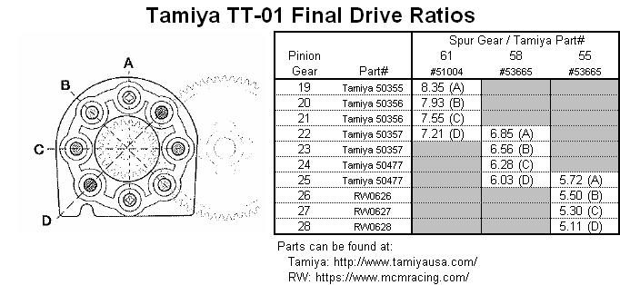

Hi Mikey, Found this FDR chart for the Tamiya TT-01 chassis on the internet...I think most of us TT-01 drivers are running the 55T spur with the 25T pinion giving an FDR of 5.72

I found that FDR to be a bit too high for the class and was able to go way lower. In my tt01 I was able to go with a 26 and even a 27 tooth pinions and you have to run lipo with them. (ordered the pinions from china btw.) Right now I am running 4.6 and it seems really good out front of my house in my TA05. Will have to give it a test this weekend.
